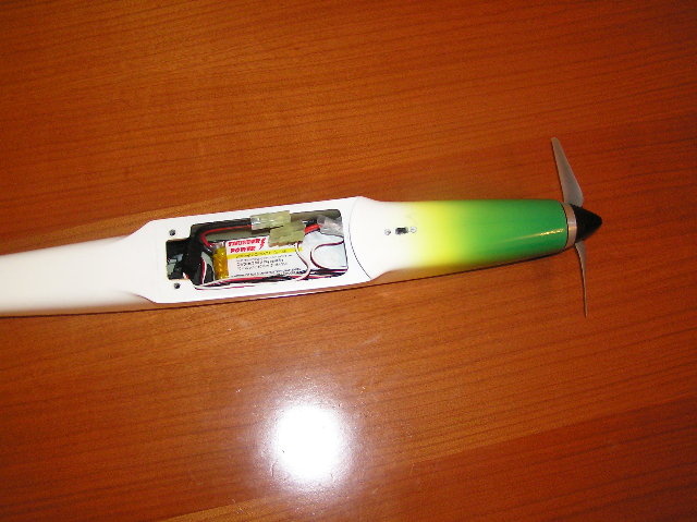

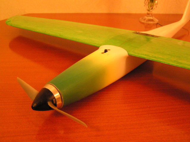

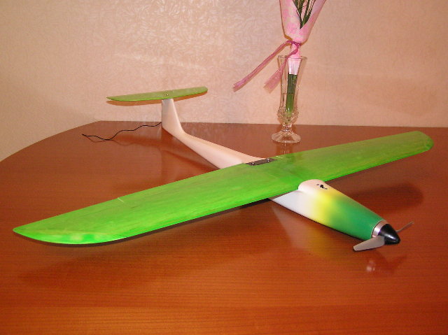

PostPosted: Tue May 10, 2005 8:54 am
我隻電機搞掂啦!配搭喺:
Hacker B20 15L Brushless Motor (不過喺大陸冒牌個隻)
Jeti Advance 18-3P 電變 (不過都喺大陸冒牌個隻)
4.5x4.1 槳
Thunder Power 7.4v 2100mAH LiPo
各位高手,咁嘅setting 夠夠跑呀?

Hi stanley,
Need to make a air intake and outlet for motor and battery colding. :D

Your plane and the gear are so hot!!!!!!!!!!! :o
beware your power plug to be too hot!!! :twisted:
