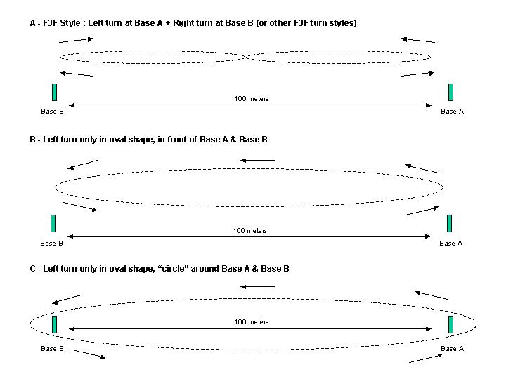

I've prepared a diagram to illustrate my question. In most pylon races, the racers are flying in "left turn" circling around the poles. So wonder the flying pattern will be like (B) or (C) or stictly be (A). Appreciate if someone can clarify.
Will the pilot be standing in the mid-point between the poles ? Thanks !

This is the race course for standard F5D. Will we use this type of course?

Hi, Wing and Henry,
Unfortunately, the rule for the competition is still not yet drafted. I can not really answer the question.
In fact, it is still open for discussion.
Personally, I think, if we adopt the rules used in F5D as Henry indicated, then we need to have sufficent judges and timing gear suitable for manning the contest. We have no experience on that!
If the track is similar to the F3F track then our existing equipment can be used to run the contest.
For safety reason, the F3F type of track has some merits as well, the judges, the CD and the whole crowd can be on one side of the track and far away from it, and we can also define a safety line to protect the workers.
What is your suggestion? All are welcome!
